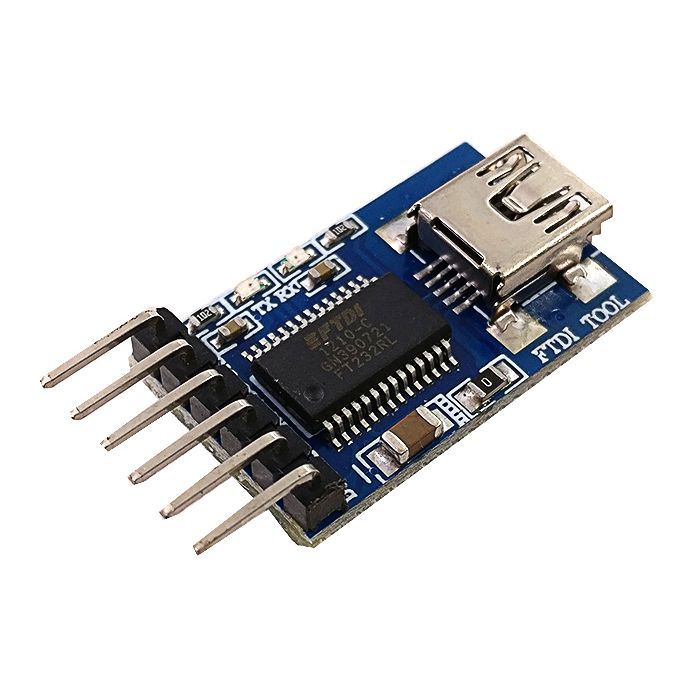

No, I am using a FTDI tool (this one)-
2019-05-03 2:22 AM
Ok that's similar to the CH340 one and fine. Your other settings are the same as I use for my Blue Pills, apart from I use a PC so can't help you with MAC drivers.
Do you have another Blue Pill you can check it with ? Otherwise I'd look at the drivers and/or the wiring to the Blue Pill.
