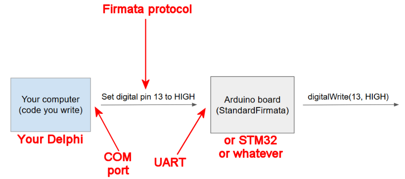

The key is to remember that the Arduino or STM32 or whatever is an entirely separate hardware unit, with a comms link to your PC - so what you need is to implement the PC-side of that comms link, in accordance with the Firmata protocol specification.

2024-02-29 6:51 AM - edited 2024-02-29 6:59 AM
@Andrew Neil wrote:the Arduino or STM32 or whatever is an entirely separate hardware unit, with a comms link to your PC - so what you need is to implement the PC-side of that comms link, in accordance with the Firmata protocol specification.
Like this:
from this tutorial on using Arduino Standard Firmata:
https://roboticsbackend.com/arduino-standard-firmata-tutorial/
it includes a utility to allow you to test it without having to write any PC-side code.
The communication is over a COM port - so, if you're implementing a Client in Delphi, your Delphi will need to interact with the COM port.
