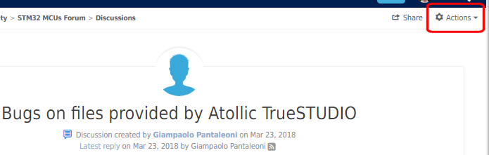

provided by Atollic TrueSTUDIO' - it's really just 1 bug in 1 file?It would be more helpful if you changed the title to something specific; eg, 'Stack length wrong in Atollic linker file'
2018-03-23 2:25 AM
I completely agree with you, but I don't know how to change the title.
Giampaolo
2018-03-23 4:07 AM
There is a gear wheel icon at the top of the thread marked 'Actions' - it's in there:
