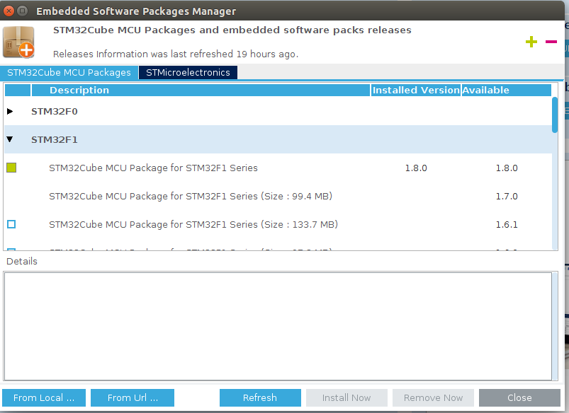

As per requirement now i have to use Ubuntu 14.04 Linux based system with Atollic TrueSTUDIO® for STM32, Version: 9.2.0 and STM32 CubeMX version 5.3.0.
I have Installed Atollic IDE and STM32CubeMX and also installed Embedded Software package for STM32F in CubeMx, reference Image attached below

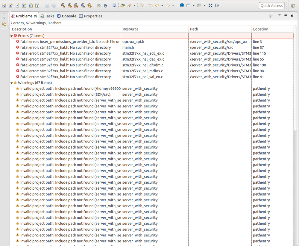

However I was able generate the code but when i compile the code i am getting error mention in the attached screen shoot.
So is there any Dev board specific package installation to be done so that it finds the HAL Library path which is mentioned in error message
Or, I am missing out on something while installations or code generation with respect to Linux based system the please help.

The first problem statement image referenced F7 error messages. This latest image is at least consistent F1. Are you still getting F7 related errors ?
Have you checked the Library config file to make sure you are including the needed peripheral drivers ?

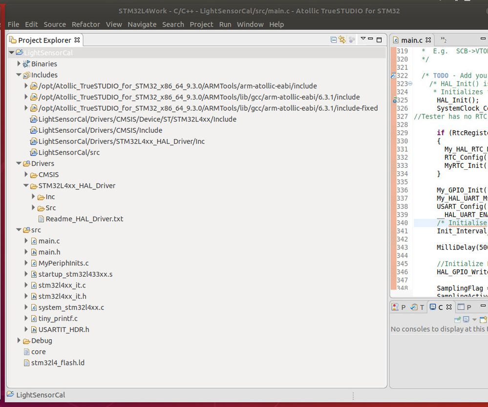

You likely have a path error.
I have Atollic 9.3.0 on Ubuntu 18.04. I use the HAL library, but no Cube, and it works well.
I have a copy of the library in each project. See screen print showing includes and source for an example.
I use an STLink V2 SWD, and a utility pops up the first time to upgrade the ROM. Not sure why, but I can't get STLINK V3 to work. I get a device not recognized error.

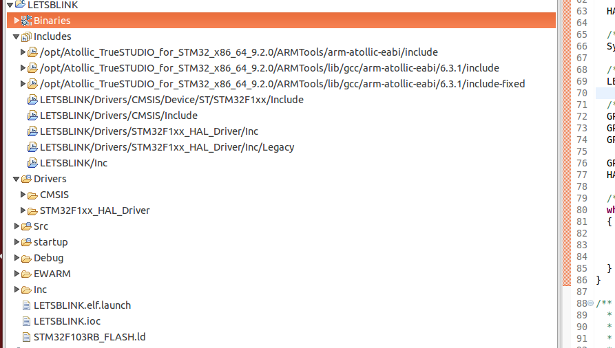

Thank You for your Response and suggestions,
" I have Atollic 9.3.0 on Ubuntu 18.04. I use the HAL library, but no Cube, and it works well. "
" I have a copy of the library in each project. See screen print showing includes and source for an example. "
I have checked in my code and i am able to see HAL driver library in the code (attached the Image of the same) but still i am getting the same error, Does this mean i have to download any other library compatible for by board and link it ?

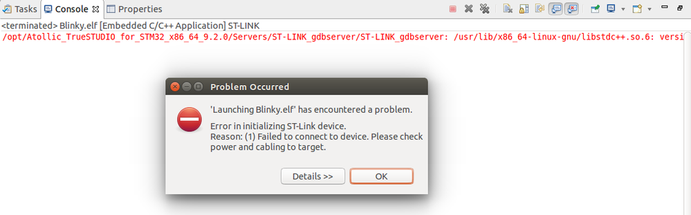

Thank you For your suggestion and help,
I am Facing issue for F1 Board and Sorry for the wrong image, It was my mistake i attached wrong Image ,
However now i am not getting path error Path Error is resolved,
However I am Facing issues while debugging the code i have attached the screen shot also,
Understanding the Error and Suggestion for Error i tried changing the Power cable with two new Cable but i am still facing the same issues.
Whereas If that Cable used for any other purpose its working fine.
So Please help me to solve the Issue

2019-10-10 4:52 AM
hello All
sorry For late response
My issue got solved when i upgraded my Linux to Ubuntu 16.04
