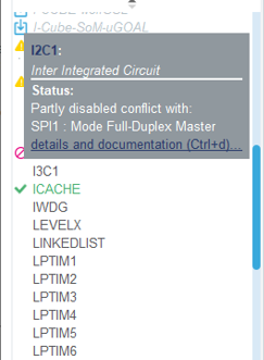

I am trying to use the SPI1 and the I2C1 simultaneously in the STM32H563ZI. Upon configuring the relevant pins in via cubeMX, I see that there is a conflict with the PB5 Pin. I want the PB5 to act as an SPI pin, whereas configuring I2C1 doesn't allow me to do that and I see a warning message for the same. However, I do not have any I2C functionality mapped to the PB5 pin.

Hi @MM..1 - Thanks for getting back to me on this topic. It's a yellow mark (attached below). This goes away when I disable the SPI1 peripheral. But the requirement on my end needs both SPI1 and the I2C1.
Thank you,
Janani

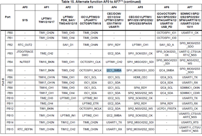

When you use PB5 as SPI1_MOSI, you can keep using I2C1 just in I2C or SMBus-two-wire-Interface.
But when you want to use I2C SMBus-Alert-mode, you need to use I2C1_SMBA pin whish is mapped only to PB5.
To avoid this problem, you can use PA7 for SPI1_MOSI.
