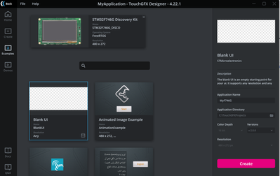

hi,
I created a simple project with TouchGfx 4.22.1 for STM32F746G-DISCO and added a label to check whether the LCD worked.
However, the LCD did not display anything after downloading the code. According to the log of compiling the code as below, the file of 'stm32746g_discovery_lcd.c' in Drivers/BSP/STM32746G-Discovery/ was not compiled or included in the project. And the lcd driver is designed for RK043FN48H LCD while it should be KUNJIAN HT043C,
May I know if there are any sample codes which can be run on the STM32F746G-DISCO version C01? Thanks.
