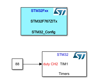

Hi, after some problems with the interface between Simulink and CubeMX, I've managed to get the TIM1 of the STM32F767ZIT working at a desired frequency and duty cycle using the next blocks:
My question is, is there any way to input a PWM signal to modify the duty output of the timer instead of inputting the duty cycle to the TIM1 block as a constant? I need to use the next signal from Simulink for example to modify the duty of the TIM1.
Thanks!

Thanks for your answer, but the PWM that I need to use as input is not external, it is generated by Simulink.

If I use the Simulink model to generate the code, the PWM that I want at the output is computed on the micro so in this case there's no serial communication.
