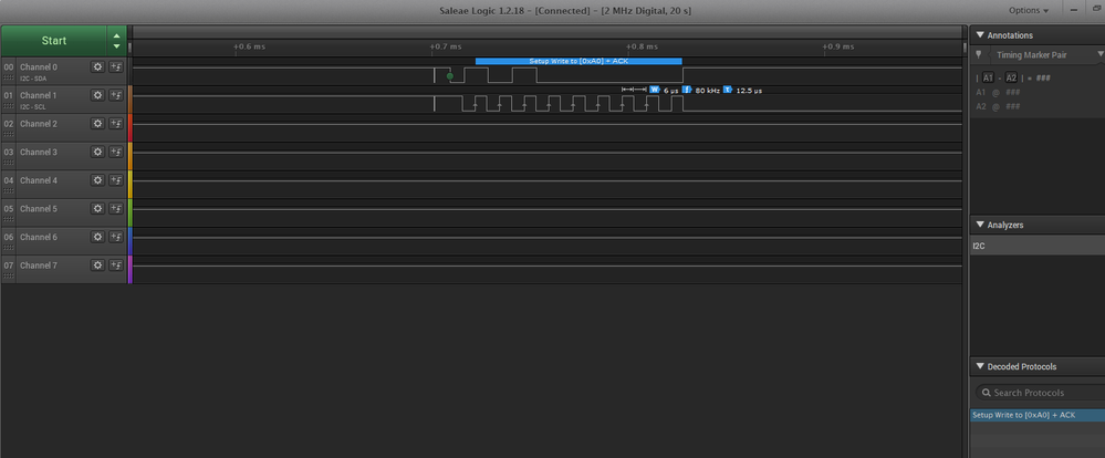

I have a problem about I2C and I saw some topics about my problem on the internet but there was no solution, I hope you help me by sheding light on this.
Problem : After sending adress by I2C, the ADDR flag in SR1 register is not set but at the same time AF Flag(acknowledge failure) is setting up. I do not use std peripherial libraries and I use stm32f429I-Discovery kit and AT24C256. I2C communicates at 80 kHz
It stucks
while (!(I2C1->SR1 & 0x0002));line, I could not find a solution. Please help me.
the code is below:

I2C1->CR1 |= 1<<9; // stopI put here logic analyzer picture when I start the code,
