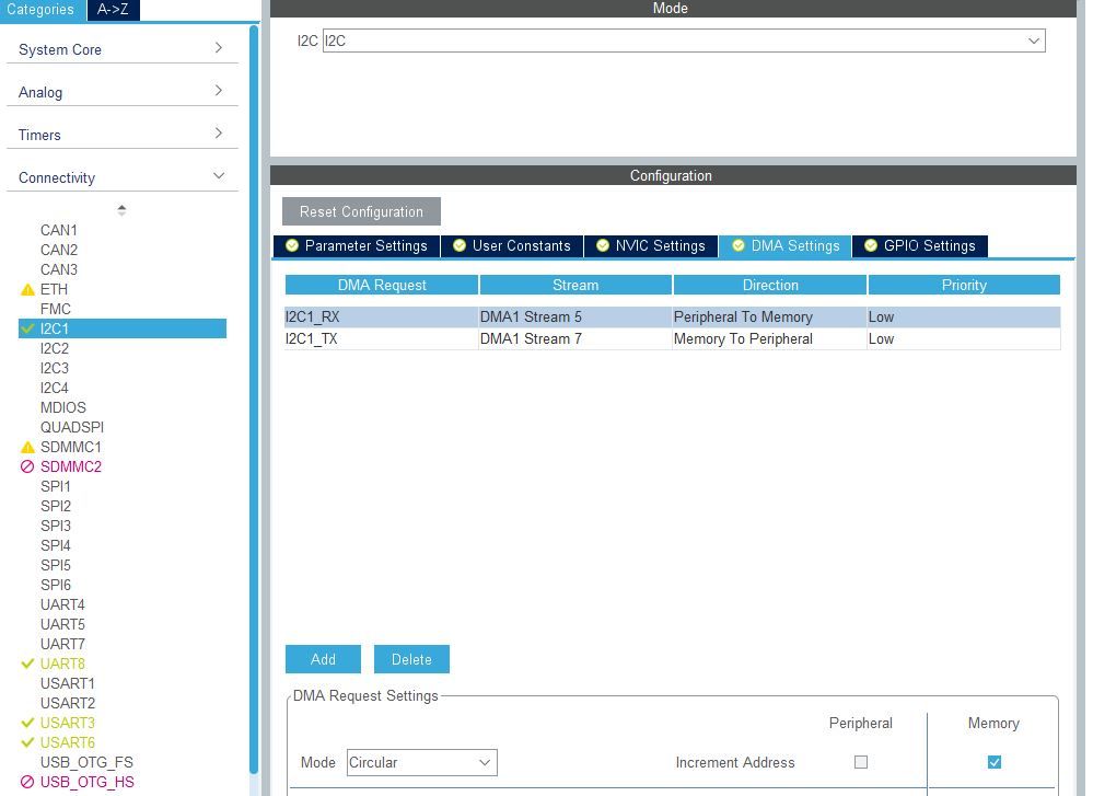

Well, ignoring the ADC in whatever mode. I want to focus only in the I2C communication protocol.
If you try to read any sensor by using I2C protocol, with the commands HAL_I2C_Mem_Read(); or HAL_I2C_Mem_Read_IT(); you can continuously read the value of that "desired" register without any problem.
But, is not the same when you use HAL_I2C_Mem_Read_DMA(); the value is not updated like there is something missing in the configuration or maybe I need to start something additional in the code (please check my I2C CUBE configuration (see picture) is based on the application note for STM32F7).

Anyway I got it, is working! I2C1_RX must be configured like Mode: NORMAL, my mistake
