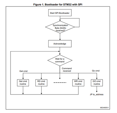

Hello @Aries16 and welcome to the community,
W5500 seems to be a SPI/Ethernet bridge.
If you intend to use the SPI bootloader, you have to take care about the bootloader protocol over the SPI:
Refer to this application note.
You need to handle the Boot pin and the reset pin of the STM32H7.
