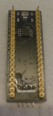

1. show your board or link
2. I have also "black pill" boards, F401 and F411 ; cpu's are genuine STM , as on most boards.
3. The "board" doesn't have to be from STM, only the CPU on the board.
4. You have an st-link ? Then try connect in CubeProgrammer and show, what its telling.
Then you know, it could/will work with the IDE ...debug... or there is a problem.
2026-01-09 10:35 AM
V3.1 WeAct Studio
