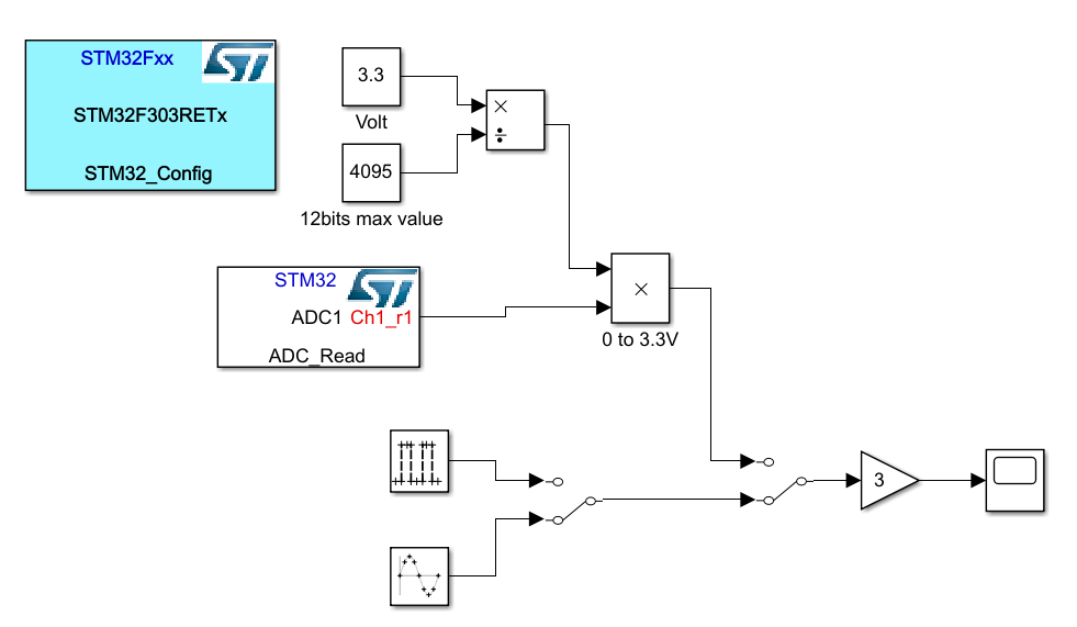

Then I looked at an example code, in the example ADC folder, I generate with the CubeMX software my new processor icon file and this example Simulink circuit.

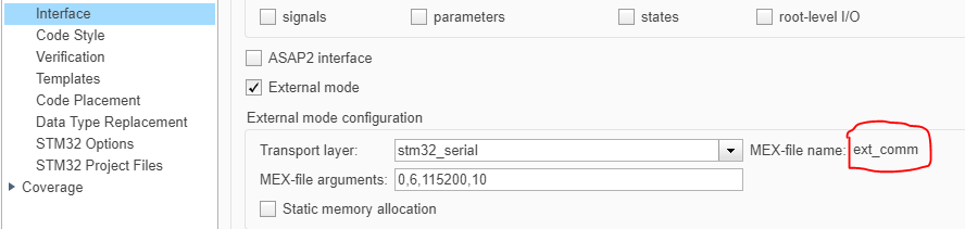

Then as I thought so a TransportLayer: ext_comm error !

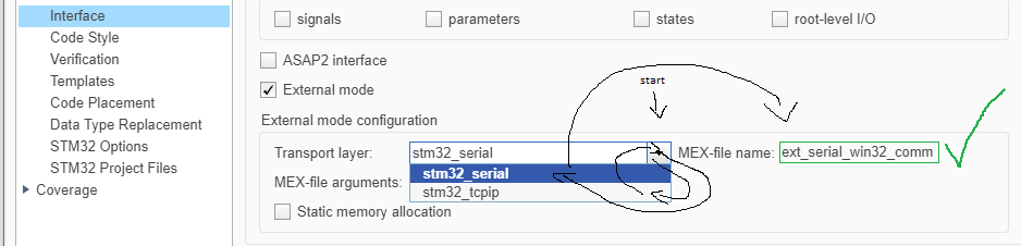

After several hours, I came up with the idea to select the rider times and back again.
A success. Again special error treatment knowledge is needed ! You must switch tcpip and again to serial to update MATLAB =) , yes.

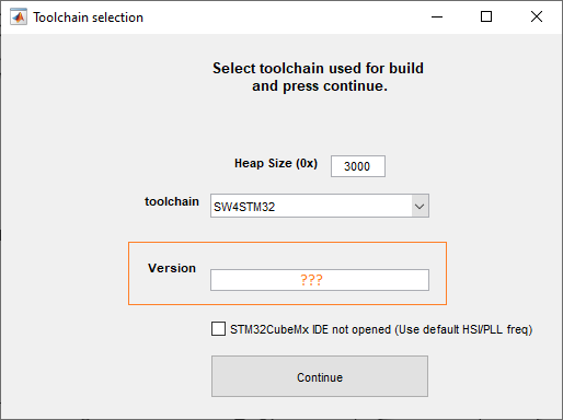

And how i must write the version number in the Toolchain selector ?
I tryed but, i dont know how it works.

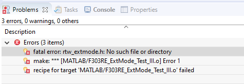

And if I gerneate the External Mode Code for standalone mode, SW4 geht this error messages.

2019-12-09 6:51 AM
Hi all,
Full compatibility for External Mode with R2019B version MATLAB/Simulink is not available at current date.
A delivery for this compatibility with R2019B is planned for 2020.
In the meantime, the delivery for the end of December 2019 is compatible with R2018B and STM32CubeMX 5.4.0.
Sorry for the disturbance.
Regards.
Cyril
