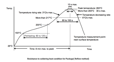

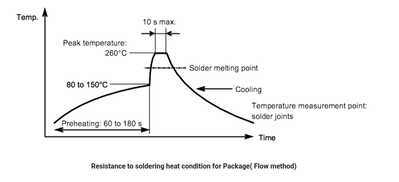

https://www.ablic.com/en/semicon/support/package/solder-temp-profile/
For hand soldering typical recommendation is: Resistance to soldering heat 260 °C/ 5 s . (for relais here)
