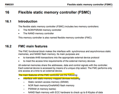

Hello @DariaLav ;
I think using external memory RAM or FLASH with FMSC interfacing can help you to solve the issue.
Thank you.
Kaouthar
