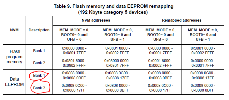

Starting a project involving EEPROM or FLASH erase/program begins with carefully reading the manuals:
The datasheet (DocID027101 Rev 3) says:
Flash program and data EEPROM are divided into two banks. This allows writing in one bank while running code or reading data from the other bank.
The reference manual (DocID025942 Rev 8) says:
You're either going to need to use an external EEPROM that meets your requirements, or create a more complex driver that manages cycle counts, and does wear-leveling. One of the most simple strategies being to journal writes across the memory, and then recover the last written values, rather than grinding data on a single spot.
