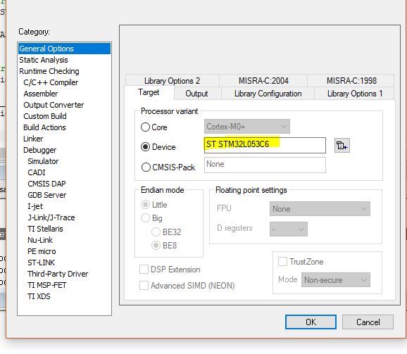

Hi, Vangelis Fortounas, thanks for answering!
My IAR project is set to compile for STM32F103C8:
I've upgraded my ST-Link utility from 4.5.5 to the latest 4.6.0 and then checked my ST-LINK V2.0 dongle's version. It was the latest: "V2.J37.S7".
I've reflashed it just in case.
The board seem to have the chip in question:
Can I do anything to make it work with IAR?
