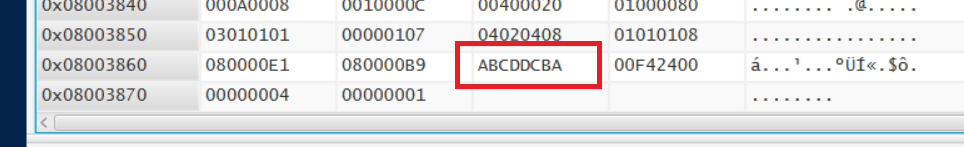

I found a solution - I can use:
const uint32_t variable_X = 0xABCDDCBA;
But is it possible to say the compiler where should be this constant located? I do not need exact location, I only need to keep always the same the location in Flash when I make some pogram changes and recompile.
