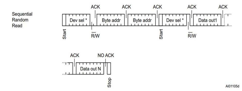

I am doing sequential Random Read command according to below attached image
with E1, E2 pulled down.
it looks like: this according to image attached at the bottom
start|0xA2|ACK|0x00|ACK|0x00|ACK|start|0xA3|ACK|0x00|ACK|...
in image there is dev sel* can u tell me what that * means or where it is explained? I could not find what it means or where the note of it is attached.
