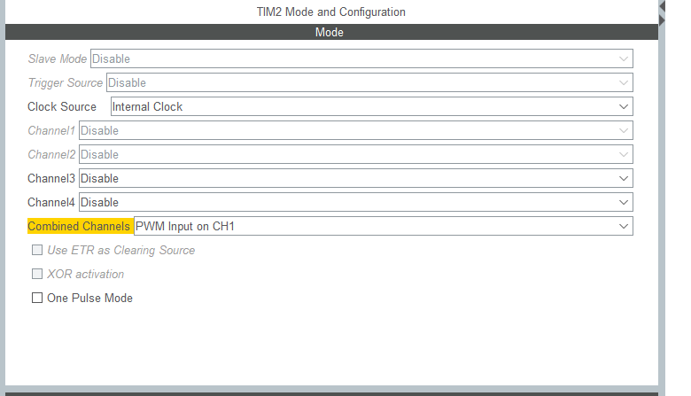

2020-10-07 1:13 PM
And did you try a Cube configuration like this?
