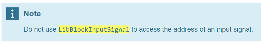

%endifI think this is not suppose to be done this way:
I would look into the function LibBlockInputSignaladdr instead.

Wow, thanks Taylor! Changing removing the LibBLockInputSignal and adding the LibBlockInputSignaladdr function in STM32\blks\mex\tlc_c\I2C_Write.tlc worked!
