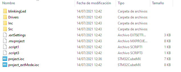

When I execute the "Build Model" button with the external operation enabled, I find that two different projects are created for STM32CubeIDE. The first one is created in the same folder were the .ioc is placed, but elements such as the ".cproject" is missing, so I cannot open it with the IDE.
The second one is generated inside "project_extMode" folder, which is created during the build. I can open this project using STM32CubeIDE, but most of the source code is missing, including the main file and the matlab code.
