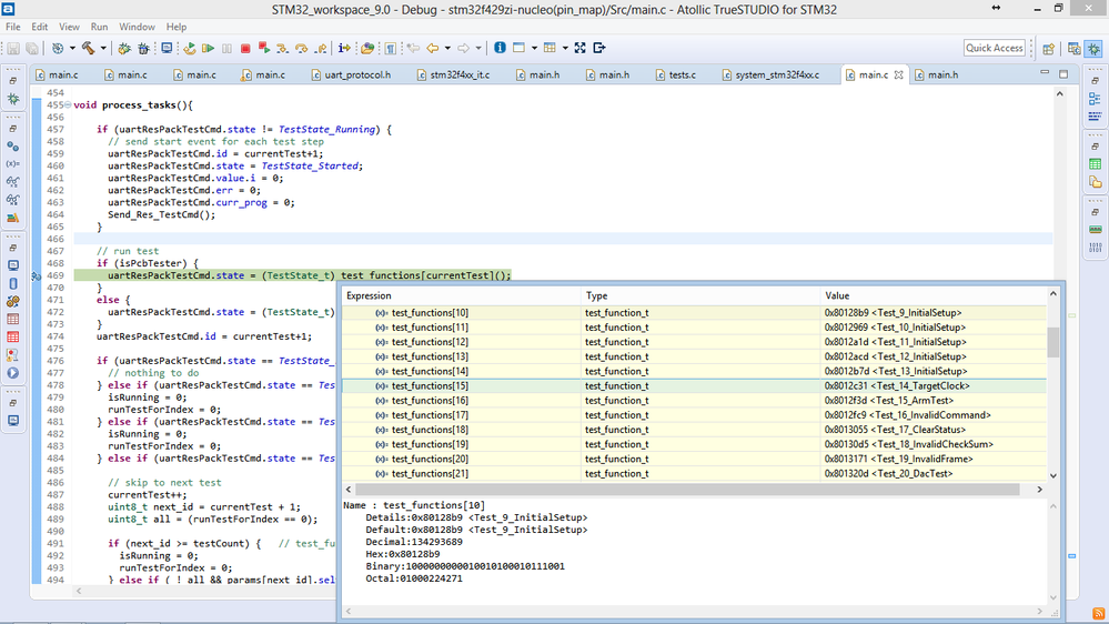

Here is the situation, there are 2 developers. Both developers download the code from the repository and issue a build & debug cycle.
Test_functions is an array of function pointers. In the debug session, Test_functions has different values (given in below pictures)
Note Test_15_ArmTest section is normal

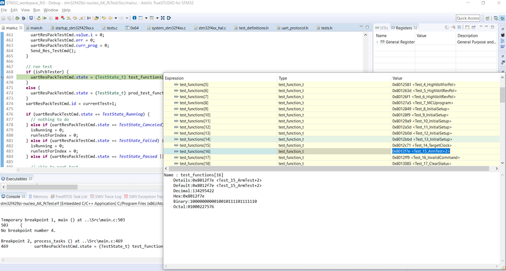

Note that in below picture, Test_15_ArmTest section has a "+2 " added to it for some reason and the application doesn't work
I think this has to do with the project properties but I wasn't able to find the cause of the problem. I tried disabling optimizations and disable dead code, dead data removal but the problem persists.
Can you please guide me about this?
