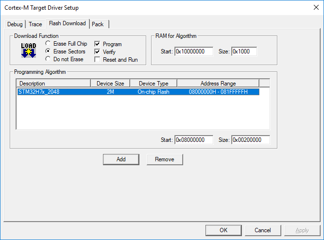

Hello @WKUNY.1
Would you please check the parameter RAM of Algorithm as shown in attached file.
Also please refer to AN5286 which provides guidelines for the debug of custom applications running on the STM32H7x5/x7 microcontrollers.
