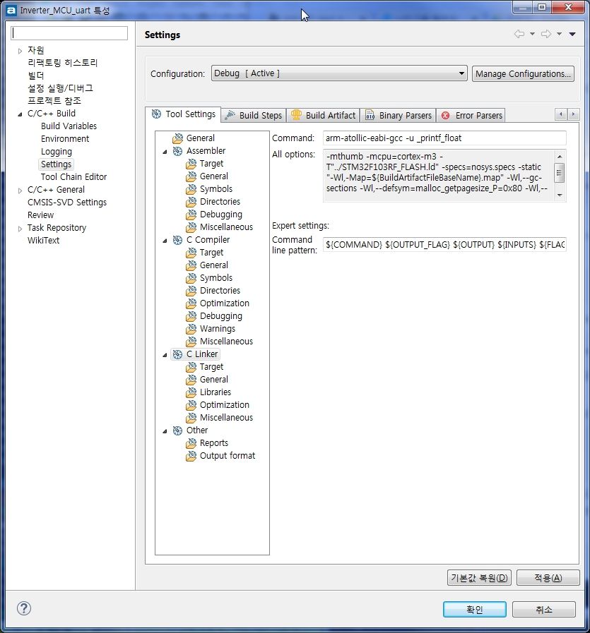

following captureis project property , add it like this at Settings -> C- Linker -> Command: arm-atolic-eabi-gcc -u _printf_float
