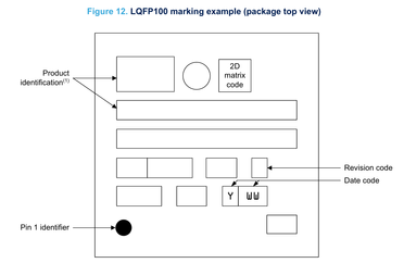

Hello. I purchased two STM32F407VGT6 controllers from different sellers. Later, I noticed that the markings were different. Is it possible to determine the originality of the chip based on the markings? The absence of the ARM label is alarming, and the VGT6 parameters have the number 6 on a separate line.

It's probably genuine. If you're concerned about getting genuine parts, stay with an authorized reseller. There isn't a parts shortage, these are in stock and available.
Markings change because manufacturing plants change and maintaining 100% consistent markings over decades is not a priority.
These chips were made 3.5 years apart from the date code.

Datecodes '533' and '211" may be 13 years apart, so expect some variance. Readout the UID of the chips and try to decipher the UID with the rules given for some devices
https://community.st.com/t5/stm32-mcus/how-to-obtain-and-use-the-stm32-96-bit-uid/ta-p/621443
and try to see if there are many batches in between...
