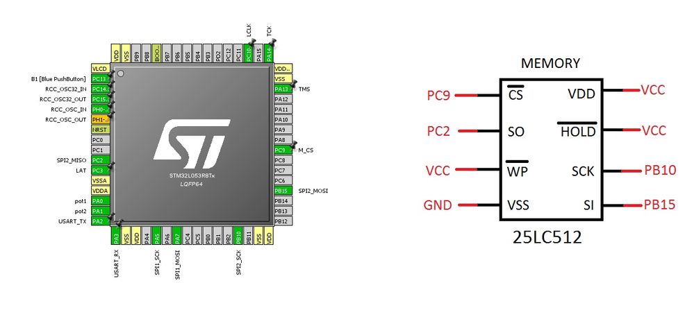

} Right, here it is the schematic (did on 'paint') and a part of my code that I use for the comunication with the EEPROM.

And does the signalling look right on the analyzer?
I'd perhaps use the TransmitReceive variant to send the command and dummy data, and be wary of the rising edge of the CS pin
