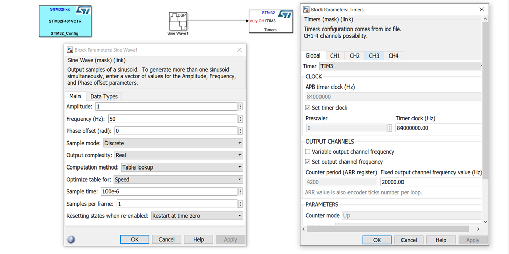

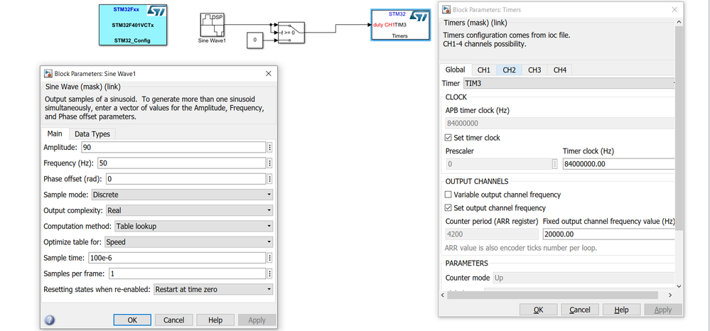

Please refer 1st simulation picture.I need sine modulated pwm for 10ms and zero output for remaining 10ms. But it is giving me pwm for 100ms and off time is 100ms. when I am changing the sampling time of sine source to 1ms then it is providing desired pwm.

Hi @VSira ,
Could you also take a look at setting the solver step size in the configuration of your Simulink model.
Regards.
Cyril
