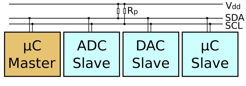

Besides, an I2C bus can be connected to more than one devices/slaves. I2C devices have addresses, so that it is possible to know what device you are currently using.
2021-07-06 6:05 AM
As @LMI2 said, I2C is a bus - the whole point of a bus is that multiple devices can share it. That's why it has addresses.
You don't need a separate I2C for each peripheral:
https://en.wikipedia.org/wiki/I%C2%B2C
https://learn.sparkfun.com/tutorials/i2c/all
https://learn.adafruit.com/i2c-addresses
https://www.nxp.com/docs/en/user-guide/UM10204.pdf
