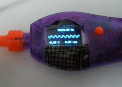

some y ago, i made a mini-DSO, with small oled-display and bigger display on the (android) mobile.
I used a F103 cpu and a BT-module (from Ali , for serial comm.) and on the mobile found app, that can be programmed to show the (serial ) data as a graph, so got the "DSO" on the mobile.
Was working good.
ed
found it , was : BlueToothElectronics , by www.Keuwl.com .
