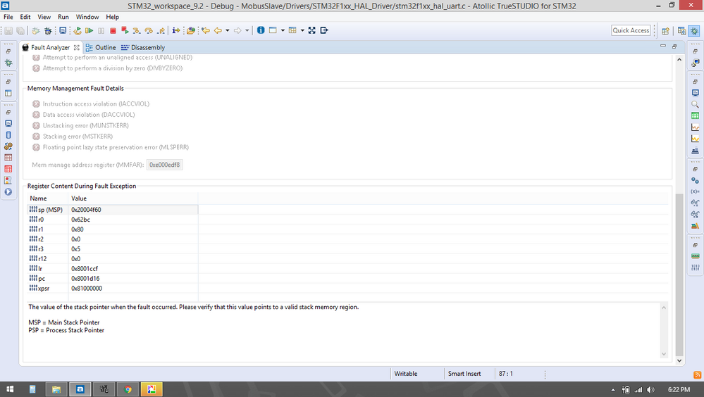

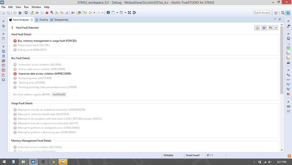

my application code running some time inside mcu then suddenly hard fault occur so i debug my application found hard fault occur inside mcu how to solve this.
2019-10-05 6:33 AM
Inspect the faulting code. There is likely a write instruction a few instructions earlier that is failing, thus the "imprecise" tag.
