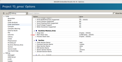

This is not exactly "function depth".
But yes, the critical parameter here is stack size, which is part of the specific project settings.
I don't use CubeIDE, so here an example from another toolchain / IDE:
In most cases, stack size is a parameter retrieved or shown during project creation, a.k.a. "project wizard".
Usually a default setting is presented you can edit at that time, or later on.
