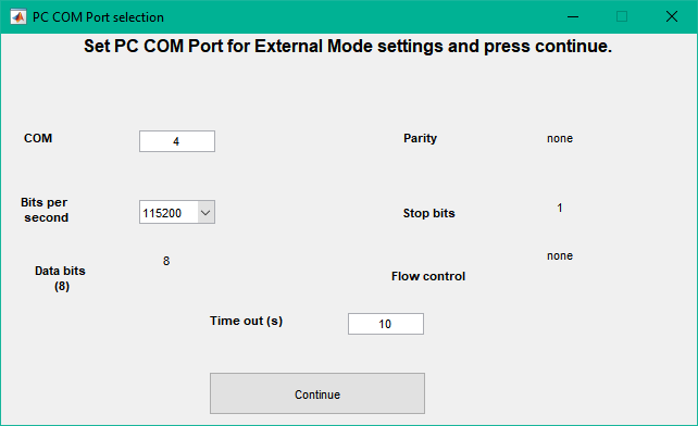

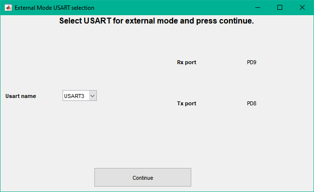

Maybe you can help me a little with understanding on how to opreate it.. do you have some answers to the questions above? Did you used only usb cable? Did you used usart2 or usart3?
2021-01-28 1:25 PM
2021-01-28 1:50 PM
Thanks!
