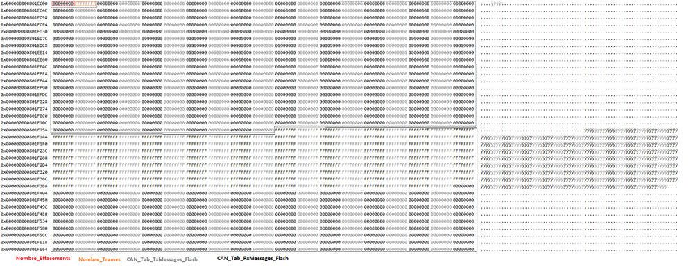

So I finally started coding, but for some reason it is not working ... Whenever I am programming something, it wil return an error :HAL_FLASH_ERROR_PROG which is a programming error. When I look at it in the flash status register, it means :Set by hardware when an address to be programmed contains a value different from '0xFFFF' before programming.
When I then parse into the FLASH memory of my STM32F1, I see that memory rangin from :0x801EC00 to0x801F17F is filled with 0x0000. Hence the Programming error.
What I don't understand is why this part of the memory hasn't been erased. Here is my code :

The function 'Sauvegarde_Flash' is the one I call in main.c to save the CAN_Tab_TxMessages in the FLASH. EcriturePreparation_Flash() is supposed to prepare the Flash for being written (unlock, erase the 5 pages, clear the flags). Finally, EcritureTrame_Flash_CANTx writes every frame of the array in the FLASH.
If you have any idea on why HAL_FLASHEx_Erase() is not working ...
Just to add : there is no special warning or error when I build my code.
Thank you in advance !

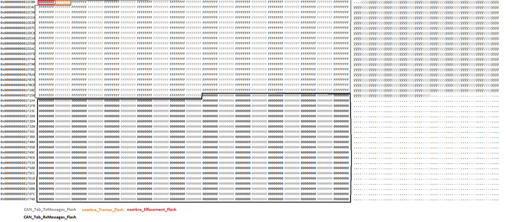

2018-07-16 8:56 AM
So, I've tried to change the address of HAL_FLASH_Program :

&CAN_Tab_TxMessages_Flash became &CAN_Tab_RxMessages. Which means that I'm trying to write between adresses :
0x801F180 to
0x801F8 But now, this part became full of 00000000 and it's full of FFFFFFFF between 0x801EC04 and 0x801F180 ...
So it appears that depending on where I want to write, the address won't erase properly ... But I don't know how to deal with it ...
I join a picture of my memory browser, if this is helping in any way ...
The top picture is when I try to write in TxMessages (for some reason, some of the RxMessages is not erased...). The bottom one is when I try to write in Rxmessages. Nombre_Trames is always well erased because I never try to write here for now.
I am stuck, I've been trying to figure out why it's not working but I just can't...
