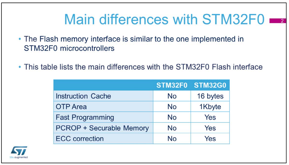

2022-11-26 6:13 AM
mod_record size need be based on ECC more info en.STM32G0-Memory-Flash-FLASH.pdf

2022-11-30 1:40 PM
Thank you all for the very helpful comments. It helped me realize that it is not possible to perform "bit-wise 1->0 flip" for the counter application, since the ECC value of each double-word gets changed as soon as the double-word value is updated. So I am limited to 256 count per 2k-page. With the 10,000 flash write limit the total 2,560,000 count capacity can roughly cover the needs of our applications. We still need to find a way to address the false "counter reset" issue, if a power down occurred right after an erase, and before the counter value gets increased and re-written back to the flash.
