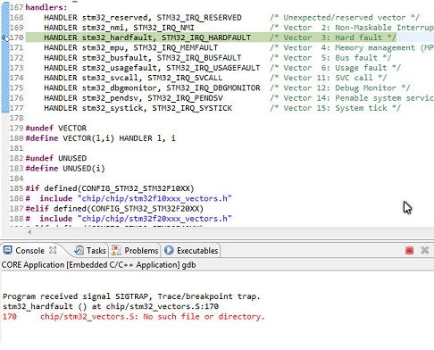

Yes, I do have latest firmware. When I step through using Segger, I see the handler for Hardware fault.
But when I try the same on ST-Link, it says no such file or directory.2014-01-08 9:52 AM
