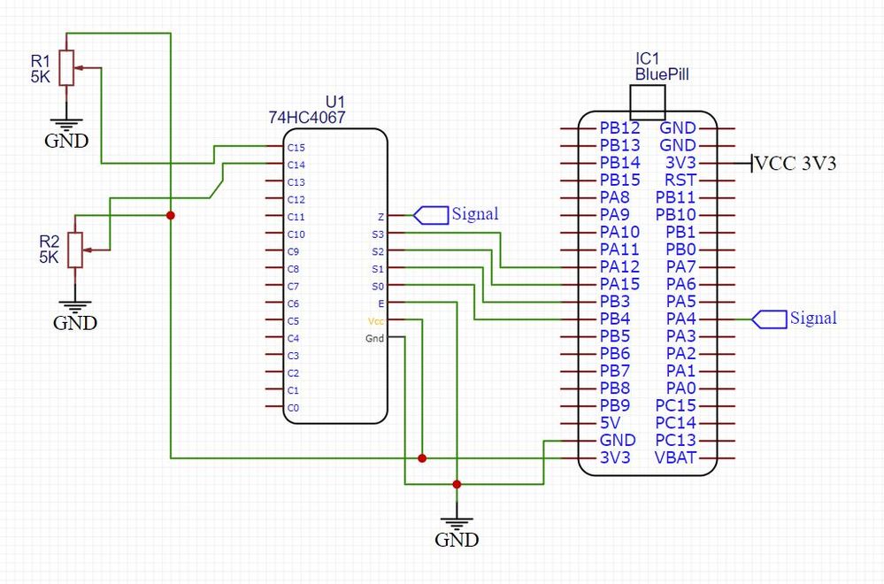

2021-03-17 8:12 AM
Could you share your wiring? maybe a paint drawing?
2021-03-17 8:34 AM

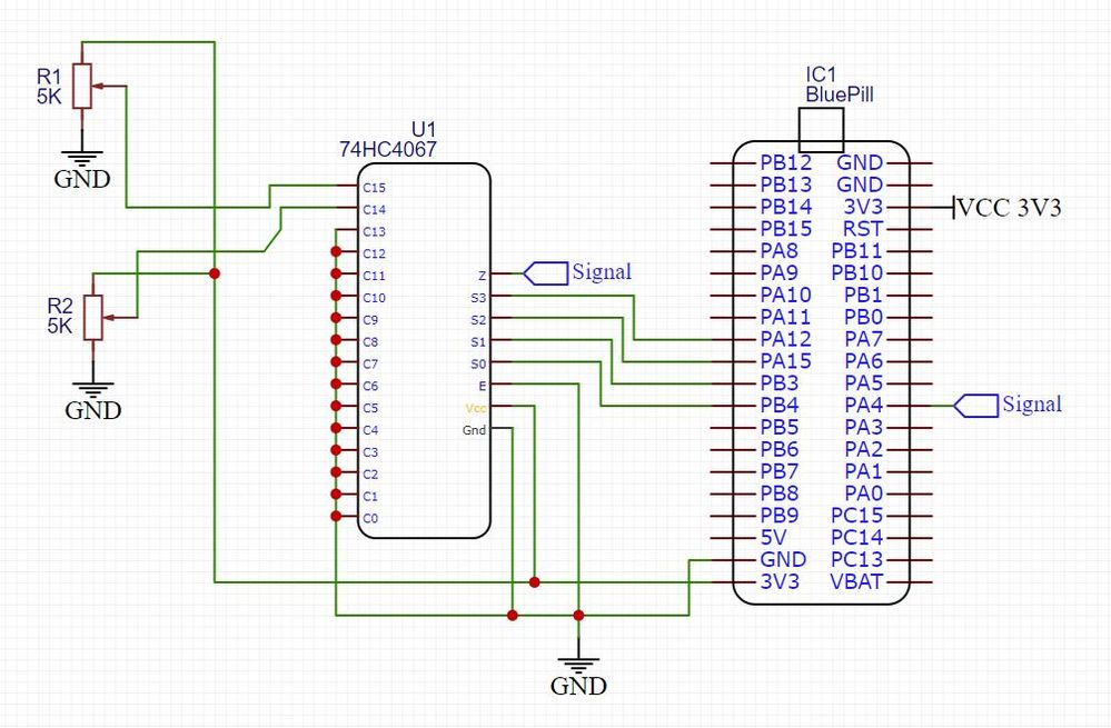

2021-03-17 8:51 AM
more accurate representation
2021-03-17 8:54 AM
This one. Damn. Of course those pins aren´t floating.
