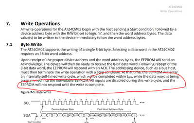

Perhaps you missed this part of the datasheet :
Write times depend on temperature and wear, so you might need to implement the "acknowledge polling" the datasheet suggests.
