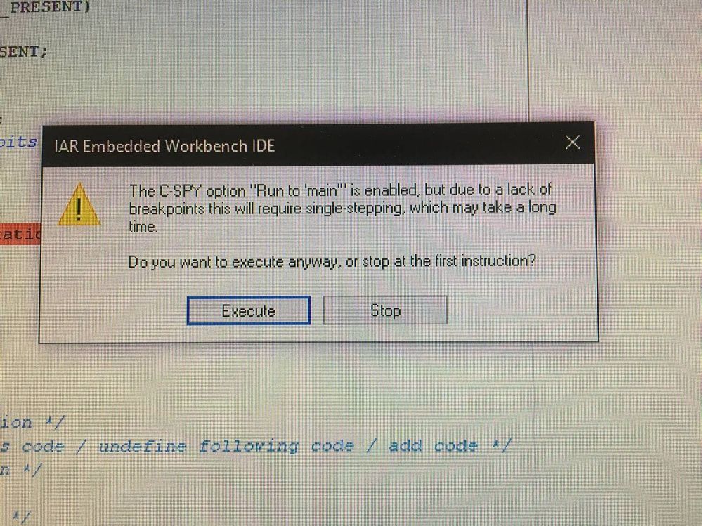

I work with IAR application (Ver:8.4) for debugging and programming. Sometimes when I am in debug mode and I try to break and reset micro via iar tool bar, I encounter this message and I am not able to break and I have to reprogram. Could you please tell me whats the reason and how I can prevent this problem. Thanks in advance

It sounds like this is due to the limited number of hardware breakpoints available. It's on the order of 4, but depends on the particular chip. I would disable all other breakpoints, or enough of them to stay within the hardware limit, and see if the error clears this up.

Which STM32?
Do you use breakpoints? Can you clear them before restarting?
Use your own breakpoint routines (via BKPT) and diagnostic/telemetry output.
Uncheck "Run to main()", use key input or loops to allow you to stop at known checkpoints.
