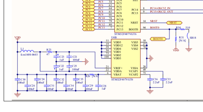

I recommend to consult the reference manual (RM0090), sections 5.1.1 and 13.2 in this regard.
Some larger packages have a separate Vref+ input pin, others not. In the latter case, VDDA is used.
The F407 discovery board does have a variant with separate pin, but connects VDDA to it.
Here the relevant excerpt from the ST F407 discovery board :
As said, check with the schematics of your board.

As I understand the datasheet and the reference manual, the normal ADC channels of the F407 always use Vref+ as reference voltage.
As mentioned, check the schematics of your board, and measure Vref+ directly at the MCU pin, in both supply scenarios (ST-Link and external 5V).
A good multimeter should be sufficient.

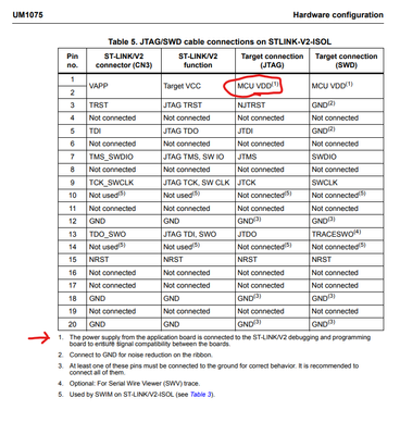

I don't think so. At least if you mean the stand-alone ST-Link device:
The user manual mentions several times that this pin is only used the "ensure signal level compatibility", but nowhere does it say it might be used to supply the target.
Newer onboard and stand-alone ST-Link variants explicitely say so if possible, and state additional constraints.

STLINK purchase link: In this there is a provision of 5V , which I used in the circuitry and measured on a DSO. It gave a stable 4.8-5V.
You might be correct , I could have used it wrong until now, but it has worked.
Which does not mean this pins is meant to supply a target, and deliver enough current.
You would have to check with the schematics, which are probably not publicly available.
But this remark in the user manual is more than a hint.
