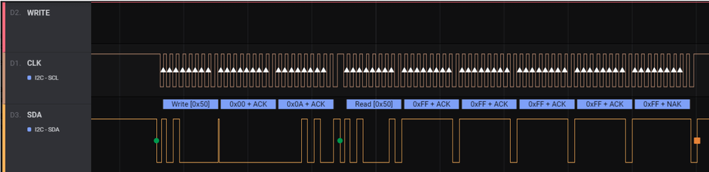

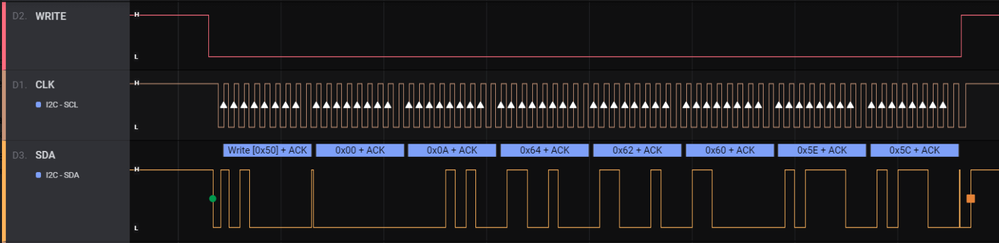

WRITE COMMAND
READ COMMAND
I've checked all pins, VCC and E0-E2 are connected to GND.
Any idea of what I'm doing wrong?
Thanks in advantage.
2021-07-19 3:05 AM
Fixed it writting a HAL_Delay(10) after HAL_I2C_Mem_Write(). Seems WRITE pin wasn't in high level enough time to carry out write process.
