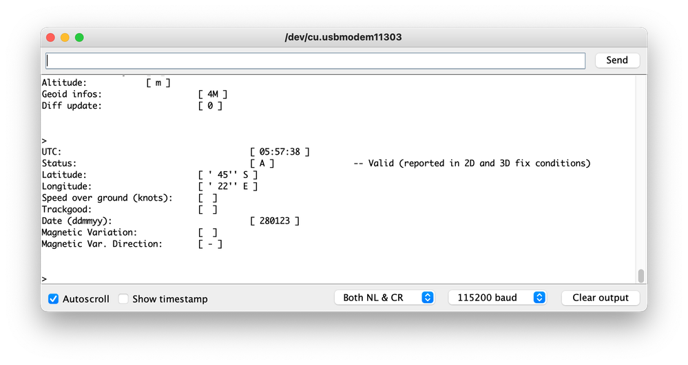

I'm using ST's X-CUBE-GNSS1 software pack but it only prints the minute part of my location coordinate

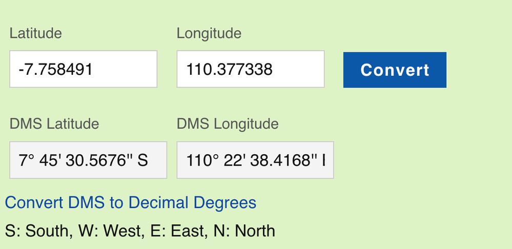

Compared with the actual coordinate that shows the degree and seconds part
Here's the software pack code that correspond with the above output

}How do I print the other two components of the coordinate?
2023-01-28 1:35 AM
You probably don't have enabled printing of float. Search this forum or internet (-u _printf_float).
2023-01-28 1:35 AM
2023-01-28 3:06 AM
Woops! totally forgot about that. Thanks!
