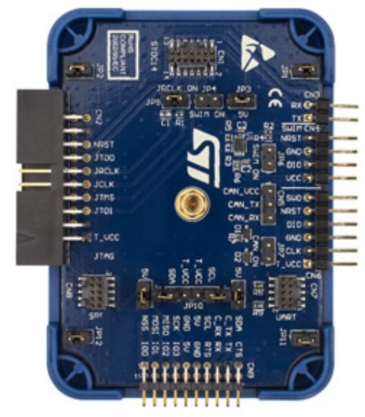

beginning the embedded systems journey has been fun, thanks to starting out with Nucleo board STM32L412RB-P. It's got an on board debugger (like any other nucleo board) which certainly abstracts the hardware nitty gritties required to setting up. Again, thanks to the rich ST community, one could find tonnes of resources and help readily available when stuck. I decided to take a little step further by purchasing a bluepill (original) and an STLink V3 SET (original). To my surprise, there hasn't been useful resources (in my opinion) on how to set these two up. Wherever the bluepill is mentioned, some stlink V2 (original or clone) follows. So I'm turning to this rich ST community, as trivial as this may seem, help me out of this quagmire. How do I do a simple debug, flash etc on my bluepill using STLink V3 SET using SWD. Thanks

2023-07-17 3:50 PM - edited 2023-07-17 3:51 PM
Shouldn't be rocket science..
The SWD interface mainly consists of SW(DIO), SW(CLK) and GND. Disassemble, add the backing plate with pin. Might want VCC and NRST, but read the manual.
Programming via STM32 Cube Programmer, via SWD connection on ST-LINK/V3

In terms of performance, you're right. With regards to the pills, I only knew of the bluepill and blackpill by the way. Never heard of the redpill up until now. My interest however is to design a custom stm32 board which I could independently flash and debug using the STlinkV3 set, using the bluepill as test case. I was able to do the flash and debug on my nucleo board using the stlinkv3 set but there's something about the bluepill I'm just not getting.

"Debug authentication" is something from another world, unrelated to STM32F1 (and L4). Ignore it. This simply means some unidentified error connecting to the chip.
2023-07-20 1:26 PM
This is more likely a issue if you have a fake part, the ST looks for ID codes, and the ST-LINK's and software won't interact with fake devices.
Also if the part is not powered or connected properly the logic and scan chains won't be functional, like at all, so like having a conversation with a corpse.. Establish authentic parts are properly powered. Perhaps look at secondary signs-of-life like the ability of the USART to respond to basic connectivity for the System Boot Loader in ROM, ie BOOT0 = HIGH, and AN3155 and AN2606

I was able to flash the bluepill using CP2102 usb to uart bridge instead (unfortunately) using STM32CubeProgrammer. No luck with the STLink yet. Again, I magnified the image of the STM32 chip on my board and compared it to what's online; it checks out. That's a source of my confusion. But thanks for your prompt responses and the new perspective about the possibility of it being fake.
