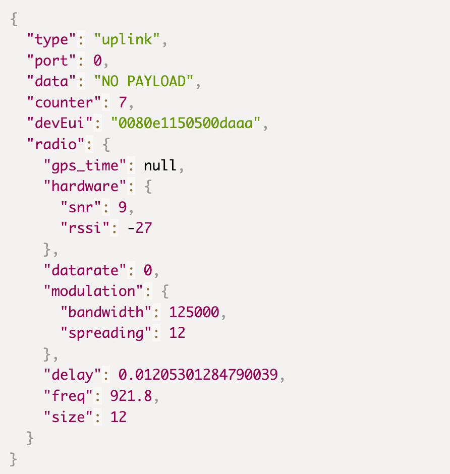

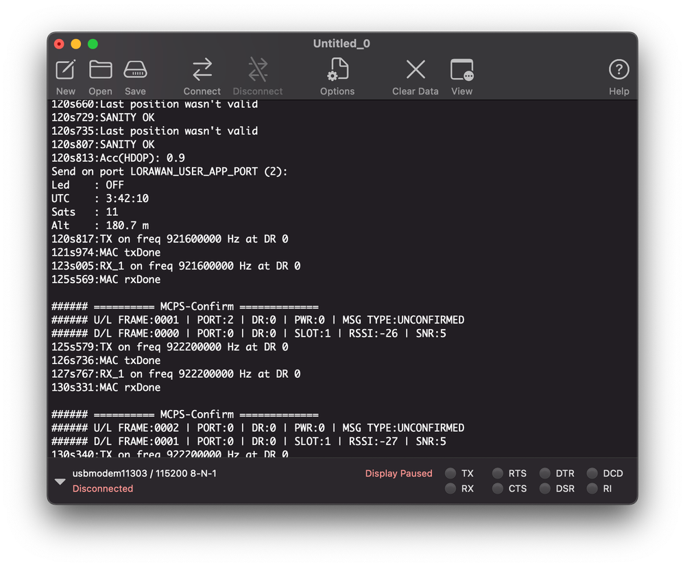

I'm trying to send some GNSS data using LoRaWAN, but my gateway only receives a blank string. Pretty sure the AppData.Buffer values are right since it prints the right thing on my console.
As you can see my gateway didn't receive any payload.

APP_LOG(TS_OFF, VLEVEL_L,
"Send on port LORAWAN_USER_APP_PORT (%d): \r\n"
"Led : %s\r\n"
"UTC : %d:%d:%d\r\n"
"Sats : %d\r\n"
"Alt : %d.%d m\r\n",
LORAWAN_USER_APP_PORT,
AppData.Buffer[0] == SET ? "ON" : "OFF", // Led state
AppData.Buffer[1], AppData.Buffer[2], AppData.Buffer[3], // UTC
AppData.Buffer[4], // Satellites
(AppData.Buffer[5] << 8 | AppData.Buffer[6]) / 10, // Altitude 1
(AppData.Buffer[5] << 8 | AppData.Buffer[6]) % 10); // Altitude 2I also attached the full lora_app if needed. Thank you.
