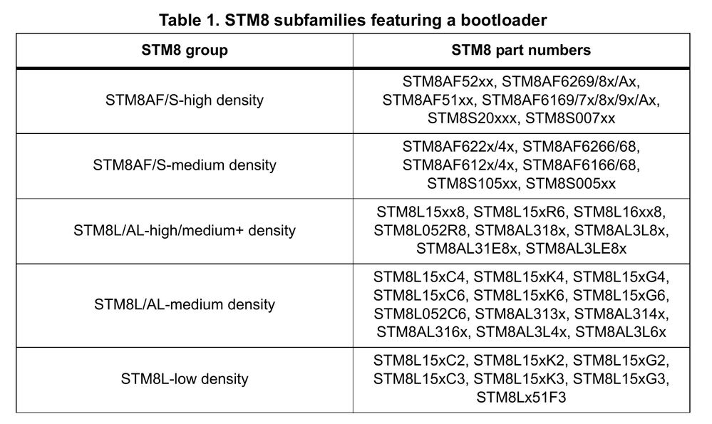

The SMT8S003 does not features built in bootloader:
(See the 6th page from the DocID14798)
The device is capable of flash self programming, but you will need to write your own bootloader.
