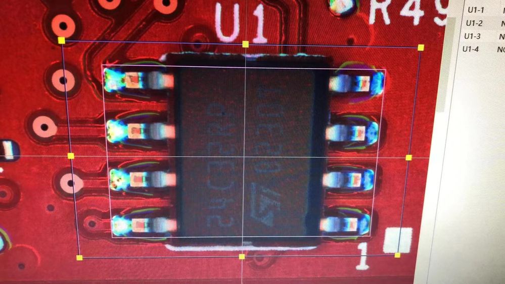

Please help to provide the body marking surface of this material. There is no description in the spec, so it is impossible to confirm whether the material used is correct. Thank you!
MANUFACTURER: ST
MANUFACTURER PN: M24C32-RMN6TP

It should be 24C32RP.

Thank you! You're right. The label on the first line is exactly what you said it was. But can you be a little more specific, because the second line also has labels
2023-04-20 2:05 AM
2nd line XYWZ depends on several parameters and i'm unable to guess because:
X is 1 digit of manufacturing plant
Y is 1 digit of manufacturing year
W is 2 digit of manufacturing week
Z is 1 digit equal to "T"
