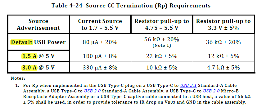

The USB-C specification defines 3 possible currents at 5V provided by the Power Source:
So the CC1_STATE and CC2_STATE bits from STUSB4500 register indicate what is the maximum current at 5V that the USB-C Source can provide to your SINK application.
A legacy USB Type-A will always have the value: SNK.Default because it can only provide the default power before USB-C was created.
However for a USB-C port, you cannot know in advance if it will provide 1.5A or 3.0A maximum. That’s why you need to use the CC1_STATE register to determine if the USB-C source that you are connected to can provide enough current.

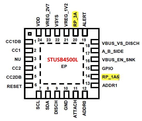

A simpler way to implement this is to use the STUSB4500L version, which has dedicated GPIO pins (RP_1A5 and RP_3A pins) to tell you if the USB-C can provide 1.5A or 3.0A.
https://www.st.com/en/interfaces-and-transceivers/stusb4500l.html

The STUSB4500 detects on the CC pin the pull-up resistor value located on the USB-C SOURCE side, and fill the appropriate register.
The VBUS voltage is supposed to start at 5V. If you provide 7V instead, the STUSB4500 will detect an incorrect voltage and won’t establish a correct connection. So it is as if the cable was not properly connected.
