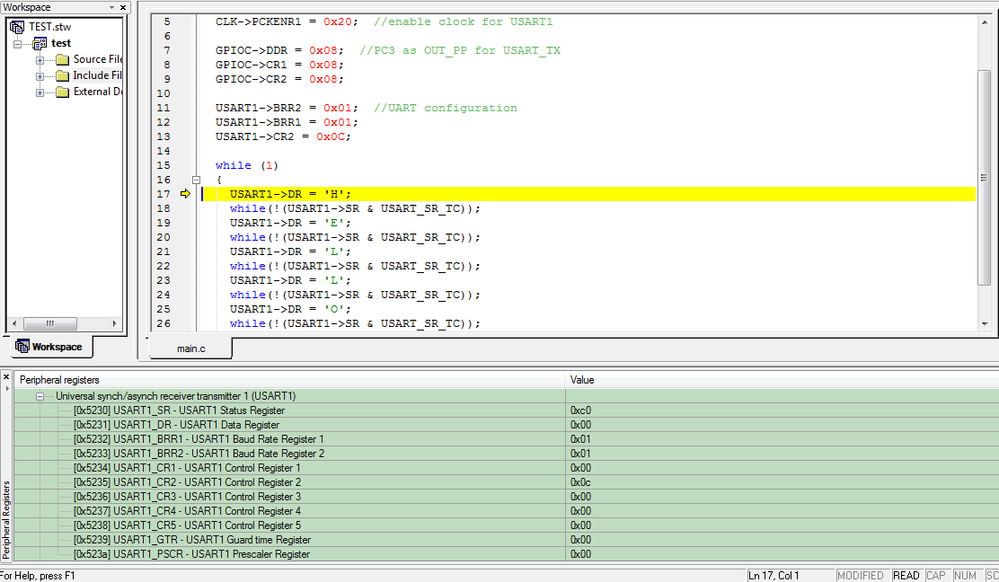

2017-06-21 4:35 AM
Hello Szymon,
I tried compiling your code but unfortunately the problem still persists
that the USART_DR register takes only 0xff value whatever the character.
I'm attaching a screenshot. Also I didn't understand the purpose of the
line while(!(USART1->SR & USART_SR_TC)) . As in what's the difference
between the condition I had written and yours.

2017-06-22 3:10 AM
This is debugging of your own code. Why is it working for you and not for me?
2017-06-22 8:10 AM
You can't inspect the DR like that, it doesn't act like a memory cell. Unless you loop-back the output externally, the RECEIVE register is not going to reflect what you put in the TRANSMIT register.
Wait for the register to be empty, and send a 'U' character, do this in a loop, attach a scope probe to the TX pin and review the signalling, check bit timing, etc.
