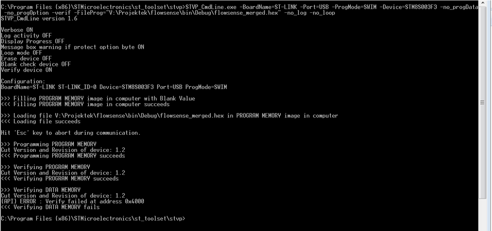

I am trying to flash only the program memory of an STM8S003F3 with the command line version of the STVP.
Even if I specify the -no_progOption and the -no_progData options it still tries to verify the data memory:

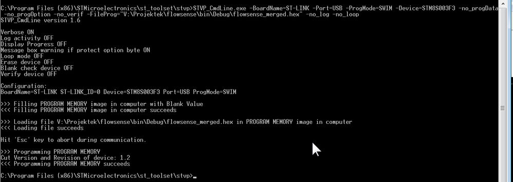

If I specify the -no_verify option then the program executes just fine:
