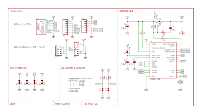

Using a STUSB4500. I am attempting to request 9V @1A from a USBC wall wart. The wall wart is capable of delivering 9V @3A.

write to 0x2B ack data: 0x1A 0x26 Attached is the schematic for the design.

Dear Richcj10,
The dead battery mode means that the STUSB4500 is not supplied when no charger is present (this mode can be used also without any battery, if the system is directly supplied from the VBUS).
In your case, as you need to constantly supply VSYS, you do not use the dead battery mode. So you can connect CC1DC/CC2DB to GND (see§2.2.2 in the datasheet).

Dear Richcj10,
When you unplug the charger, you observe that it comes back only to 5V when you re-plug.
It behaves as if the negotiation between the charger and the SINK fails.
Could you record the traffic on I2C and on CC lines after the unplugging ?
Then, what is the role of D10 ? I am afraid that there could be retrofit between 2.7V and 3.3V.
Where does 3.3V come from ? Is it supplied by another part of your circuit ? Does it switch off when you remove the charger ?
You can try to remove D10 and connect VSYS to GND.
A 1µF capacitor is also missing on VDD.
Where does 3.3V come from ? Is it supplied by another part of your circuit ? Does it switch off when you remove the charger ? - Supply VSYS when VSUS is 0V. I tried removing the diode and no change. The 3.3V stays consistent. It is from a internal battery. In the dev board linked above removing the diode prevented dead battery mode from working.
You can try to remove D10 and connect VSYS to GND. - Can you explain this mode?

Dear Richcj10,
In most of the cases, VSYS is connected to GND. It can be connected to 3.3V when you want to save some power (the system supplied by 3.3V will consume less compared to VDD power supply).
In your case, you have connected CC1DB/CC2DB for dead battery compatibility so the STSUB4500 does not expect any power supply when no charger is connected (VSYS and VDD should be 0V).
Let me know your tests results.

I did note that with my current circuit design, when in dead battery mode, the diode allowed VCC (3.3V in my design) to be back feed to the rest of the circuit from the 2.7V rail. This caused the IC to not run properly. In the future I will prevent 3,3V from getting back fed in this state. I need the VSYS to be present to allow I2C traffic work in absence of USB.
