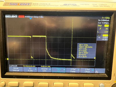

The only waveform I am in possession of at the moment is a unplug-plug event where the charger was broken (not the STUSB4500).
Unsure if this can provide some information.
Will try to recreate STUSB4500 failing and capture waveform of VBUS/CC.

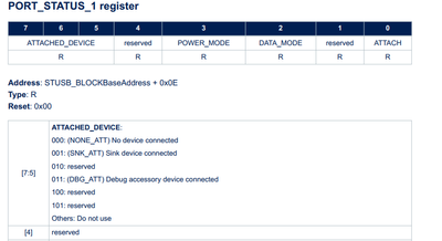

When connected to computer (USB-C, 5.0V VBUS no PD) we read back PORT_STATUS_1 -> ATTACHED_DEVICE and it sometimes report 0x02 (reserved). Do you have any explanation for this?

Having @x0E=0w02 is symptomatic of unlike reset. May I suggest to use 1k or less (instead of 10k) for Reset pin ?
